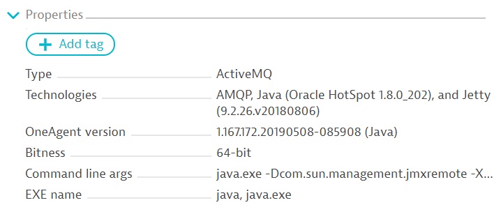

Thanks for quick replay,
of course I mean python plugin.
I actually resolved my problem. Your suggestion to set process type as JAVA was right, actually ActiveMQ is type 10(JAVA) and a few other but I dont need to precise process type that accurate. Activemq.jar name is unique enough. Technologies(ACTIVE_MQ) that you suggest to set was wrong as you can see in image below. In fact I don't need to set technologies at all, but I set AMQP.
