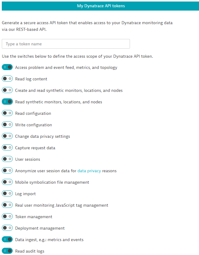

you can also use the api to export data into your Remedy platform:
-Chad

To integrate with another CMDB you would call the Dynatrace SmartScape API to extract the Hosts, processes and such and then import them into the other tool using that tool's method. That's actually exactly what our ServiceNow integration does.
If you don't have the time or resources to do this yourself our services department can help you out.
