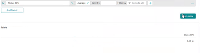

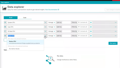

Hi @Radu
Thanks for the prompt answer!
Here it goes:
1.
2.
3.
Let me know if you need any more information
Thanks again
Yos
22 Feb 2022 10:42 AM
While the second screenshot is not splitting by an entity - I think I found the issue 🙂
