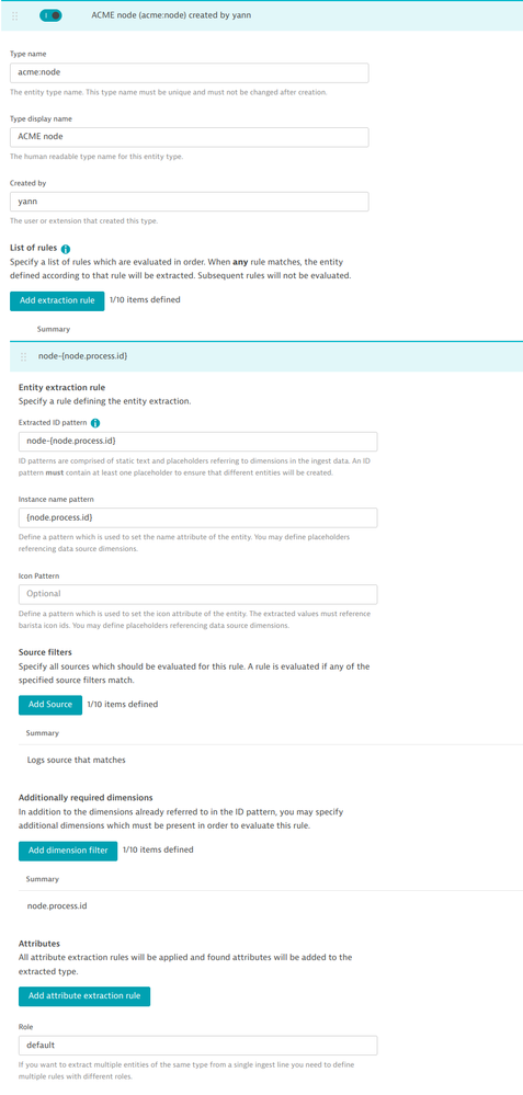

Yes, you can build up a custom topology based on logs. You have to define two custom types, where the source is logs. Then sure create a required dimension - so that only relevant lines will produce custom topology types.
You should define two custom types e.g.
  • acme:node
  • acme:transaction-flow
Both will be created by logs:

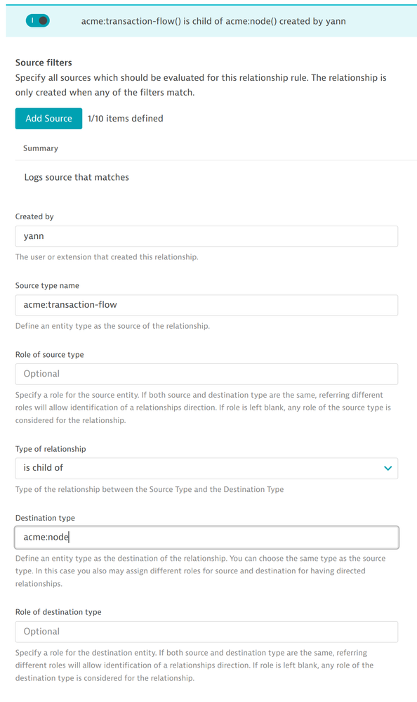

The acme:node definition should look like this - the transaction flow similarly:
and then the relation like this:
I highly recommend doing it as extension 2.0 from scratch and defining it in the extension yaml (unless you have just a single environment where it needs to be set up). It's then easier to define unified analysis screens for such entities.
