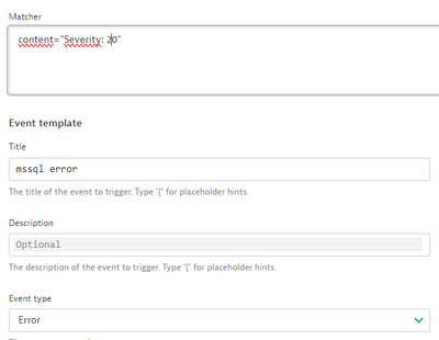

I think you can get this creating a processing rule and a log event .
The processing rule to doing something like this to capture the second line to use the content capture in a custom attribute that you will use in the log event.
The log event to capture "severity:20" content for event type "Error".

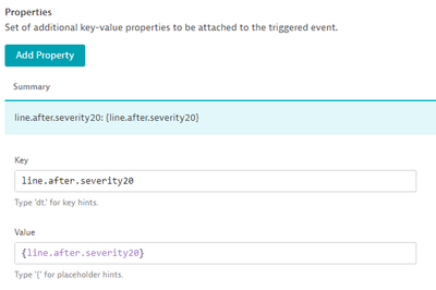

And finally, adding the custom attribute you define in the processing rule like:
Hope it helps.
