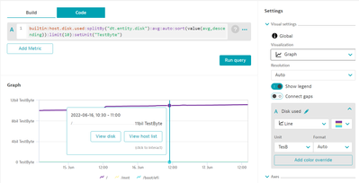

There is a metric builtin:host.disk.used:filter(and(in("dt.entity.disk",entitySelector("type(disk),entityName(~"/pgerrorlogs~")")))):splitBy(" dt.entity.host","dt.entity.disk"):avg:auto:sort(value(avg,descending)):limit(10)
Can I add custom values to the end of the metric like "Gb"
Hey Super,
There is a feature that allows you to define custom units to be used with metrics. This allows you to create whatever units that you like! Although if your new unit is a a billion or million or etc of something then you'll have to do the math in the data explorer yourself. See the below images for reference.
This is the settings page for my example TestByte unit.
