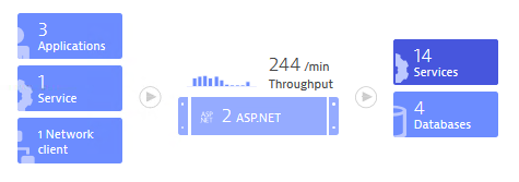

Process group:
This is the API server, 4 of the 14 Services are apache webserver http

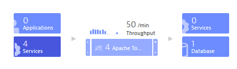

And the application with the 4 apache web servers

The Apache on the last screen is not apache http server but (probably) Apache Tomcat.
henk_stobbe
DynaMight Leader
DynaMight Leader
Yep, but the apache webservers are part of the dark blue boxes and talking to the Tomcat.
FYI in the same environment I see that the same, but without the apache webserver so communicating direct to a tomcat has no issue's

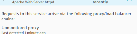

henk_stobbe
DynaMight Leader
DynaMight Leader
Found it, I hope,
IIS -> Apache HTTP Server -> Apache Tomcat
is
IIS->proxy->Apache HTTP Server -> Apache Tomcat
So the proxy must be "terminating" the purepath?
Julius_Loman
DynaMight Legend
DynaMight Legend
Yes, depending on what is the proxy in the chain it might be filtering HTTP headers added by Dynatrace.
