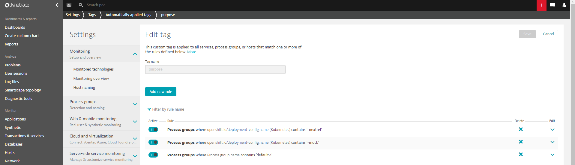

I would like to create an automatic tagging rule for Java process groups which uses the value of an arbitrary system property as a tag value. Is this possible and if so, how?

Would it be a possibility for you to extract the system property "purpose" out of the detected process group name, because there the system property can be used for separations of process groups?
I don't think that will work because the system property value can be an arbitrary string (it may even contain blanks etc.) and therefore can't be matched with 100% confidence.
The whole point is to avoid having to create manual mappings for each expected value and instead use the system property value directly as identified by the system property's name.

It seems a bit odd that Java system properties can be used for process group detection but not for tagging... Seems like the feature that evaluates them is already there but just not enabled for creating tagging rules... Would this be a good candidate for an RFE?

Thanks - I will consider raising an RFE. Our process groups are already auto-detected correctly and adding tags to them is not really the problem but rather using dynamic values according to system properties....
An example:
We've used the existing values of a system property called "deploymentPurpose" as an additional criterion for splitting process groups more granularly i.e. "deploymentPurpose=nextrel". Now it would be great if we could use the same property for tagging as it can have the same value throughout different process groups (due to multiple detection rules being evaluated as an "OR" condition) and it would be useful to filter it.
