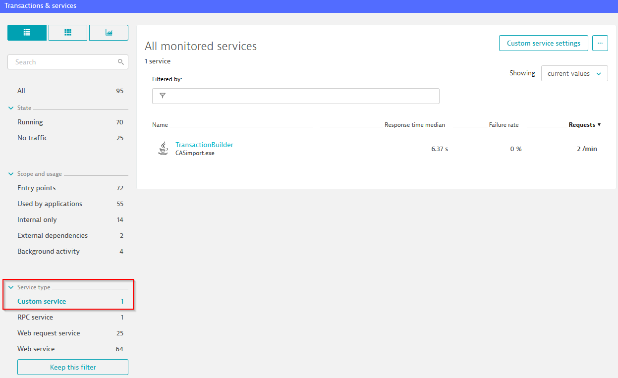

You should see the custom service in the Transactions & services overview.
You can use the filter for Service Type: Custom service:

Thank you @Patrick H. for your answer. I was trying on a test batch :
public class Entree {
public static void main(String[] args) throws Exception {
doIt();
private static void doIt() throws InterruptedException {
while (true) {
System.out.println(" Il est " + new Date() );
Thread.sleep(5000);
and it didn't work (?).
I tried on my real batch, and now it seems to works.
Thank you for your help,
JP
