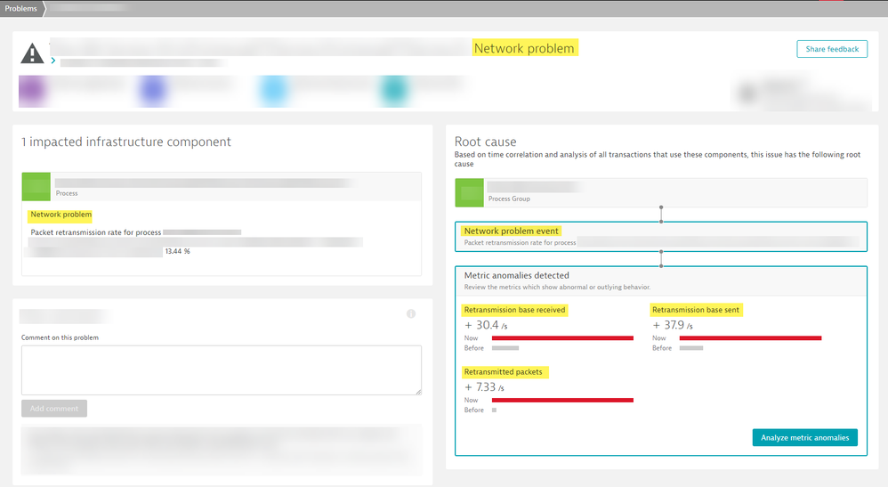

Can Dynatrace in its "Problem analysis" point to the network device as a root cause of the problem?
echwallah
Helper
I have a client who wants to onboard Cisco routers and Juniper network devices.
The question is, can Dynatrace in its Problem analysis point to the network device as a root cause of the problem?
Could I get share a screenshot where this is possible on the problems page?

it should be able to if you can onboard those entities. Here is a sample of a network anomaly and how it was detected, granted its at a process group level but I imagine it could apply to your onboarded network component.
