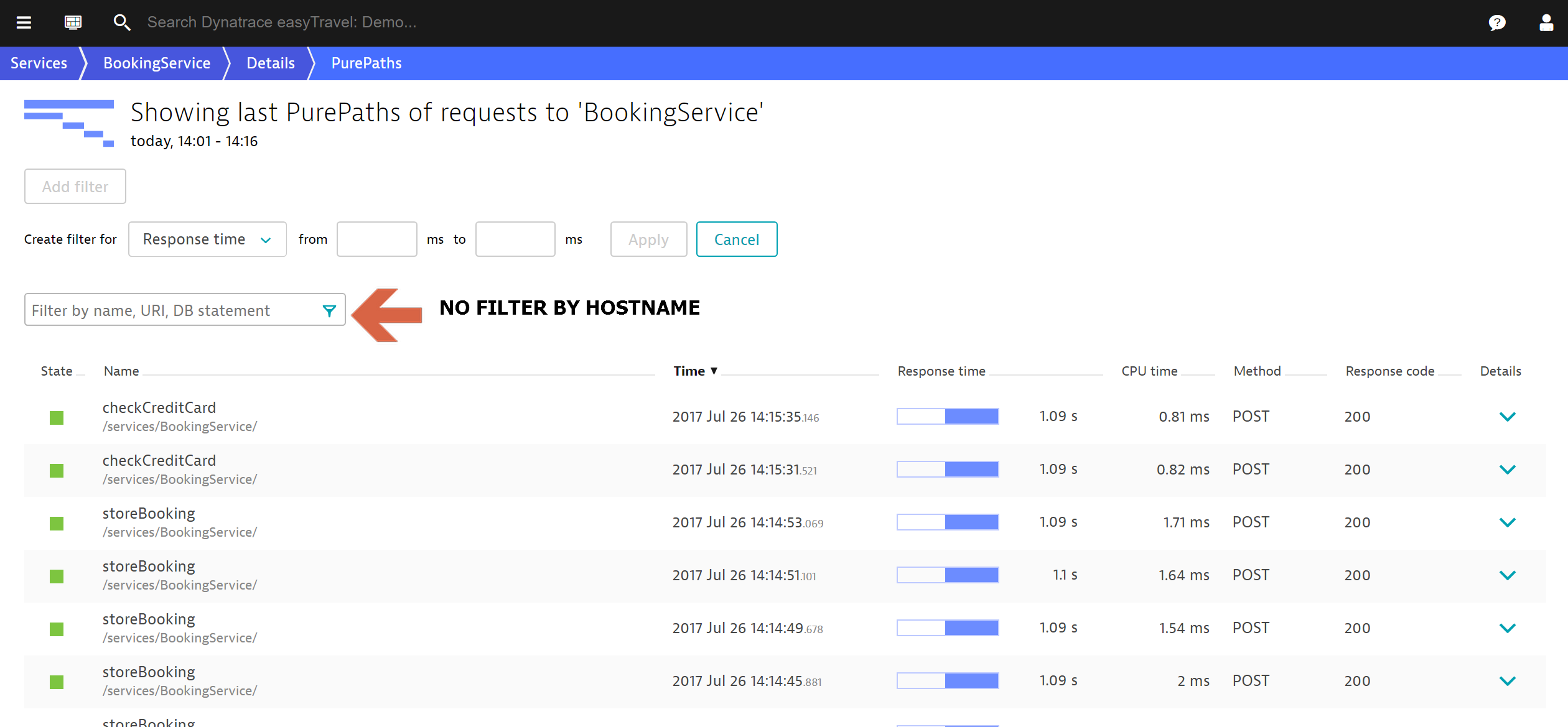

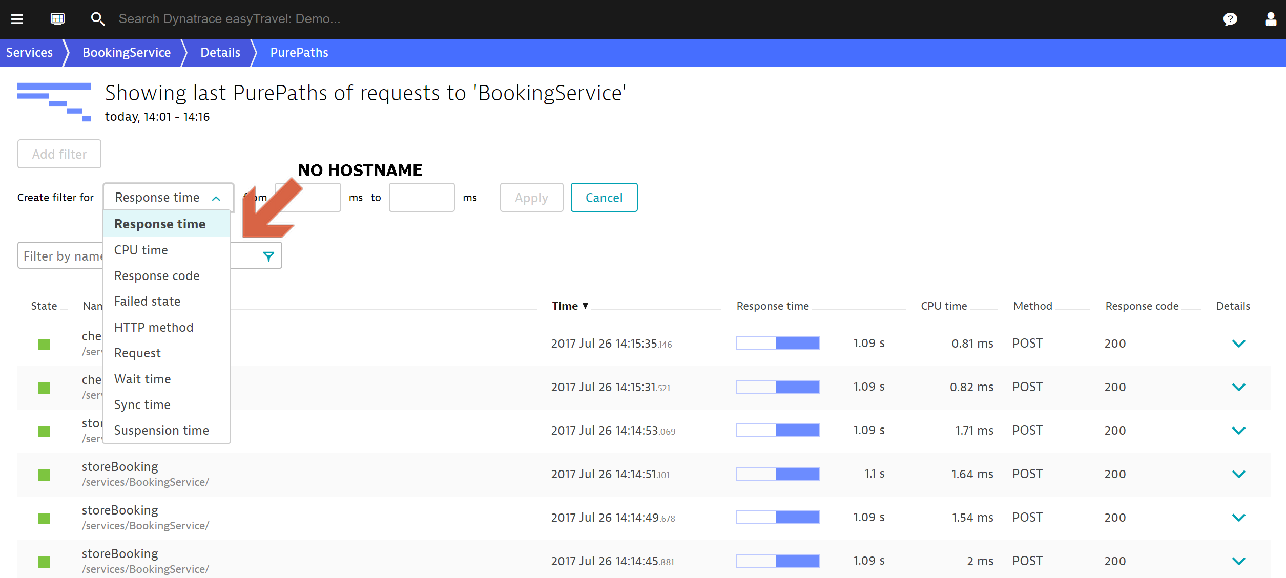

Hi there,
I'm trying to find a way, if there's one available at the moment, to filter the purepaths by Hostname. If you take a look at the screenshots below it seems currently not doable..am I missing something?
Thanks in advance,
Raff

yes that's exactly what I'm looking for, but as you can see from my previous screenshots, there isn't any "Instance" filter available in my dropdown menu...
Could it be related to the version?
Thanks, Raff

@Raffaele T., I think it may be related to technology. Your screenshot is probably from one of the other process groups like VMWare or OpenStack. They do not offer the "Instance" option as a filter.
Please click on "BookingService" on your breadcrumb and then expand "Properties and tags".
If the Process group is "eT-OpenStack-BusinnessBackend" or "eT-vmware-demo-1-BusinessBackend", it won't give you the option to filter by instance.
However, if it is "eT-demo-1-BusinessBackend", then you will be able to filter by Instance, as Hayden's screenshot demonstrated.
