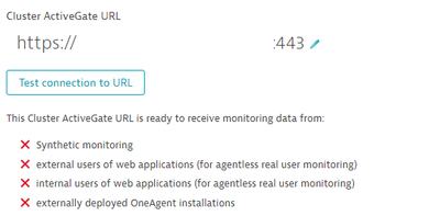

Dear All,
I am setting up a Cluster ActiveGate for Mobile RUM and Synthetic monitoring while Testing connection to URL I am getting below issue.
Is SSL certificate is a mandatory thing for Mobile RUM?

Hi Mohit,
you are getting these errors because your Cluster ActiveGate is not reachable from the Internet. You need to set a publicly available URL that your Mobile Users can reach.
Regarding your second question: all communication is encrypted so you'll need a working SSL configuration.

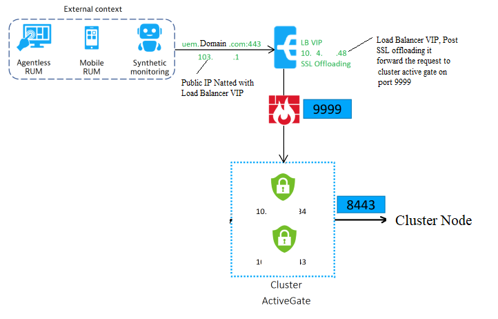

Hi Babar,
Julius is correct, I have implemented the same using Load Balancer. For your better understanding please find the below architecture diagram of what I have implemented for one of our clients.
Hello @Julius L. and @Mohit G.
Thank you for your reply.
We have the same setup. I meant traffic is terminating on the LB using port 443 and then natting with LB VIP and forwarding traffic to the Cluster ActiveGates.
Do we need to open the Firewall for TCP port 9999 between LB and Cluster AciveGates?
This is the different thing I found in @Mohit G. diagram.

If there is a firewall between the LB and Cluster ActiveGate that is blocking the ActiveGate port (9999) you definitely have to open it.
Yes,
If there is a firewall b/w LB and Active gate you need to open port 9999.
Regards,
MG

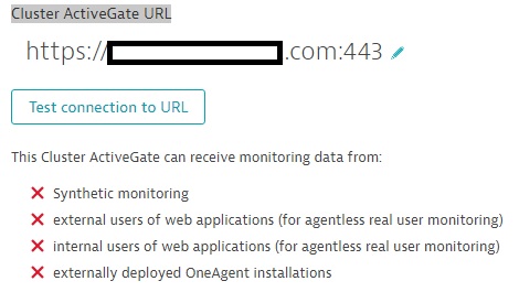

As it shows SSL certificate problem and I see you have an IP address written in the URL.
The Cluster ActiveGate or the F5 (not sure which one does SSL termination in your case) has a certificate. Please check the certificate as likely it is not valid for the URL. The URL should be a valid FQDN and certificate returned by the ActiveGate or the F5 must have a match for the FQDN.
Hi Babar,
Definitely it will not work. As per the screenshot, you are providing IP and Port (Probably the public IP) it will only work for intranet communications, not for the internet. When you click on the test connection what Dynatrace does it tries to access that URL from mission control or their Datacenters and it checks the SSL certificate for a secure connection which is a must for Dynatrace to communicate from an external context. Procure an SSL certificate with a Domain name and install it in LB then provide the URL with a domain name in this field it will surely work for you.
Instead of IP address provide a valid doamin name.
We have a valid SSL certificate which is terminating on the F5 LB.
When I use the URL, test connection to URL fails for all the options but with IP address 2 options are passed as shared in my first screenshot.
Following is the configuration. Can you please verify?
https://domain.com---> Public IP DNS: 000.000.000.115 (Port 443) ---> NATTED IP F5: 000.000.000.110 (Port 443) ---> Cluster ActiveGates Servers: 000.000.000.128 , 000.000.000.129 (port 9999).

Hi Babar,
The configuration seems to be correct, are you specifying the port 443 when you enter the domain name in cluster active gate URL? if not just try once and check.
It will look like https://domain.com:443
Regards,
MG
Hello @Mohit G.
Following is the result with URL.
Do we need Proxy/Internet configured on the Cluster ActiveGates?
Regards,
Babar
You don't need any proxy. ActiveGate is only listening for requests in those cases.
You have a mismatch of the URL and the certificate issued in the first screenshot. In the second screenshot, I guess your load balancer (F5) is not balancing requests for the domain and they are unable to reach the activegate - check the F5 rules in this case.
Just a simple check : in your browser. go to the ActiveGate URL you have specified with the path /mbeacon - so something like https://dynatrace.domain.com/mbeacon according to your screenshot.
And check the output. It must not give you any certificate warnings and it should give you the output:

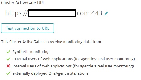

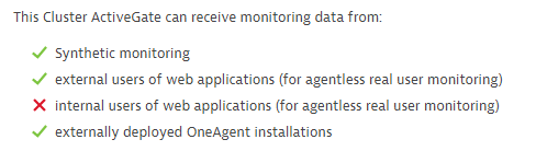

Hello @Julius L.
At last, I got the following:
missing querystring
Below is the current status. How to resolve internal users of web applications issue?
Regards,
Babar
My guess is that the URL provided is not reachable from the cluster node and it might be OK in your case.
I'm not sure how Dynatrace validates this option.
Can you try if you can reach the /mbeacon from your internal network?
This might be also a DNS issue since in enterprises domain resolves different records internally than externally. Just validate from your PC in the internal network if you can reach the URL. Might be just the case the hostname is even not propagated to internal users.

Hello @Julius L.
We already have done these changes and Synthetic monitoring started successfully.
Now the only pending thing is the following:
internal users of web applications (for agentless real user monitoring) is not resolving.

Hello @Julius L.
What could be the reason for the intermittent test connection to URL Passed/Failed?
Regards,
Babar
As I have written before - you changed the activegate port and now the F5 is talking http to your https endpoint.
Hello @Julius L.
Apologies. I could not explain my point well. F5 is reconfigured to talk to the Cluster ActiveGates on Port # 9998 instead of 9999. In the same way Cluster ActiveGates, also configured for the non-ssl traffic to accept.
We started collecting Synthetic data with up and down status e.g. in the below screenshot you can see the grayed-out area for all the locations and I am unable to understand the meanings of No data legend, therefore, I also opened a different question for the same subject to discuss for better understanding.
The strange thing is that availability is showing 100% for all the locations even with almost half of the grayed-out area.

The diagram is exactly the configuration we have. How are people going about testing whether it works or not? What does the “Test connection to URL” do exactly so we can trace where communications are failing?
