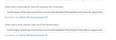

Anyway I can configure SLO on specific key request, instead of that service as-a-whole?

You can add filter to the metric to to pick the key request you are looking for.
The filter will look something like:
builtin:apps.other.keyUserActions.count.osAndApdex:filter(eq(dt.entity.device_application_method,"DEVICE_APPLICATION_METHOD-B60A00B9A3831556")):splitBy(dt.entity.device_application_method):sum:auto
