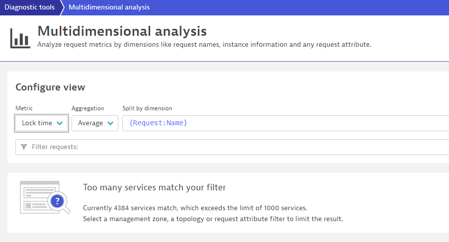

you can do this via the Multidimensional Analysis chart - let me know if you need any assistance setting this up:
@Chad T. Thank you for looking into my post and responding. I would love to see if you can provide more details. Thank you once again!
so you might need to go full stack for full monitoring, but go to Diagnostic tools, and select "Create Analysis View"
From there select the metric you are interested in, the aggregation and the dimension if need and you can also filter the results if you are not using management zones.
