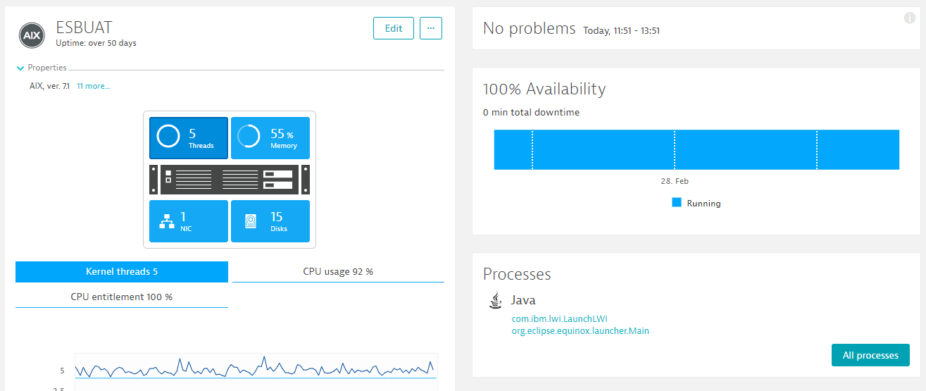

Hi All,
I have installed Dynatrace OneAgent 1.159 (latest available for Dynatrace managed ) in ESB server running WebMethods 10.1 by Software AG (OS Aix 7.1). But one agent is unable to detect the WebMethod process or broker process.
I have checked in the supported technologies and it is supported by Dynatrace.
Please help

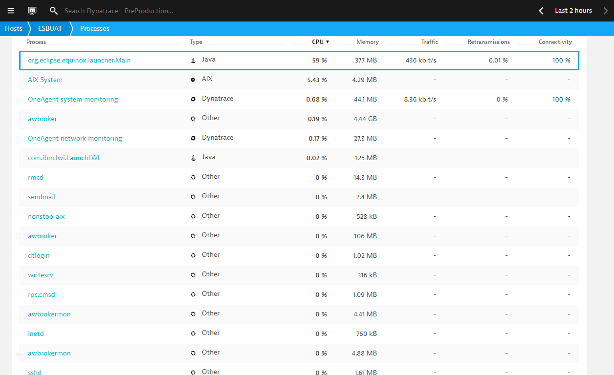

Below are the process running in the Host

Hi All,
We are now able to monitor the Software AG webmethodsIntegration server process successfully, now we are stuck with the Software AG webmethods broker server.

Hi Vicky,
Software AG web methods integration server monitoring is supported OOB, you just need to install Onegent and restart the servers process. Dynatrace will automatically detect the process technology and start monitoring the same.
Incase your installing in AIX, you need to define LDR_PRELOAD as mentioned in the below link

Hi Bart,
Dynatrace does support Software AG web methods Integration server process OOB, so you will be able to do in-depth monitoring of web methods Integration server, but Dynatrace doesn't support Software AG web methods broker server.
