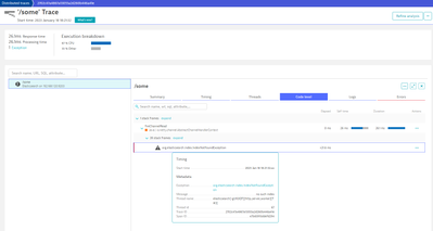

You can see how it look in Dynatrace - with fully instrumented ElasticSearch on screenshots.
In my case, I call elastic with curl. So I can see this call and PurePath because ElasticSearch is instrumented - agent in Full-stack mode. I can see exception and e.t.c.
I wouldn't be able to see these CURL PurePaths without instrumentation.
