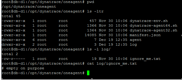

Did you check the agent log files?
Does the agent platform match the host platform ?
omichael
Participant
the agent log file is empty... yes its 64 bit Solaris 11 platform
attached logs
Well, it seems you are not using the Solaris agent correctly. On Solaris systems, the OneAgent is available only as the PaaS agent. That means it is not a standalone application and will not run as a process in the OS and you don't actually "run the agent".
With PaaS agents you just need to export appropriate environment variables in the execution context of your monitored application (preferred) or run the application using the dynatrace-agent script.
Basically, the LD_PRELOAD variables are used to load the OneAgent library to the application.

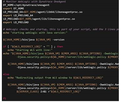

omichael
Participant
after injecting the environment variables in the to Oracle WebLogic startup script we are able to see the Solaris node on console !!
Great to hear it's finally working for you.
omichael
Participant
i got it working with starting my application with passing the environment variables & it was shown on the dynatrace webconsole
Hello @Orwin L.
Did you pass the environment variable to particularly?
What did you pass exactly?
Regards,
Babar
in startup weblogic.sh script & restarted weblogic instance
