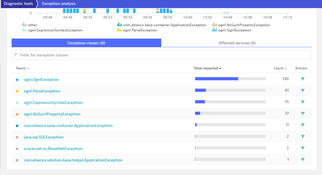

In Dynatrace Diagnostic tools > Exception Analysis, I just can see the exception class not with the message.

In order to look at the messages you will need to get into exception details at the class level.
Check documentation for more information

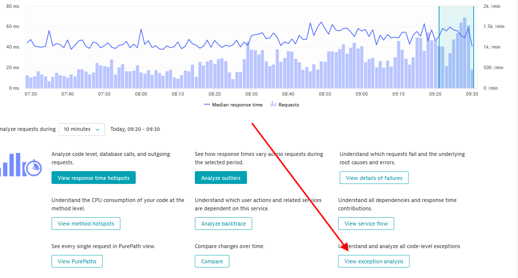

I normally search for Exceptions at the service level, following the box shown below. In Diagnostic Tools, you will get all Exceptions for your Environment. Might be useful for searching for the most occurring ones, but might be difficult, because of the huge number of them...
