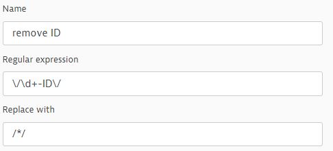

You have: http://example.com/112412-ID/do_this.jsp
and you need to delete 112412-ID.
You can add this rule:
After enabling you got
Page url http://example.com/112412-ID/do_this.jsp
Resulted page URL: http://example.com/*/do_this.jsp
For http://example.com/112412/do_this.jsp
you need use this rule:
\/\d+\/
I hope it will help. If not - specify what needs to be excluded.

Hello Gustavo,
You need go to Service settings > web request names
Regards,
Alexander
29 Jun 2020 02:27 PM
Thanks for the reply, I sort of found it under clean up URL rules, but I was looking for the "replace with" functionality which doesn't seem to exist anymore.
