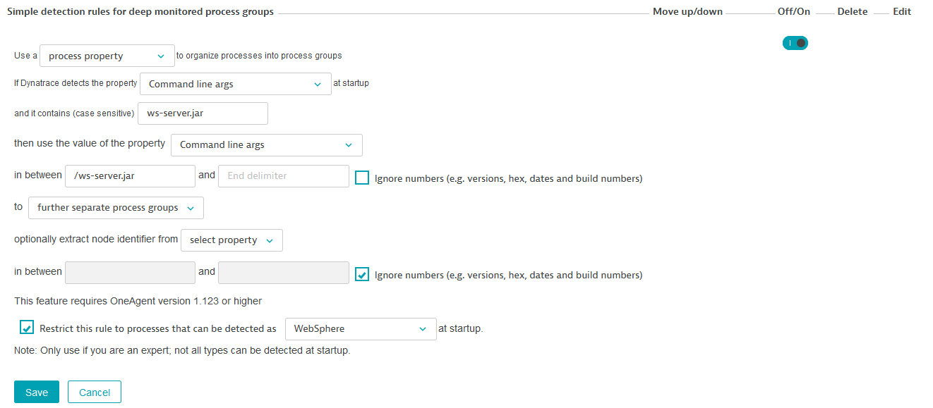

27 Aug 2020 12:32 PM
Hello @Patrick H.
I tried with the below configuration, but no luck. Did you see that the below configuration is correct or not?
Regards,
Babar
27 Aug 2020 02:07 PM
Hi Babar,
You have to insert the values in the forms in line 4 of the configuration. The value you want to use for the Process Group Detection should be between the first delimiter and the end delimiter in line 4.
Please have a look at Based on process properties in the following section:
https://www.dynatrace.com/support/help/shortlink/process-groups#process-group-detection-rules
Best,
Sia

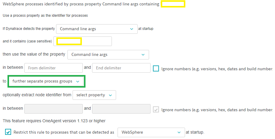

30 Aug 2020 01:41 PM
Hi Babar,
Based on the (limited) information provided, I think this should work:
Please ensure that the Processes are restarted. Also ensure that the first delimiter form ends with a space as highlighted in blue in the image. If the command line args simply end with the server name, you can keep the end delimiter empty.
Best,
Sia
