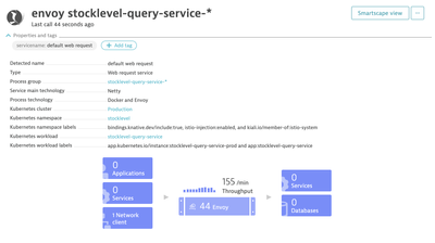

But for me I only see process connections but nothing on service level (no incoming or outgoing service connections):

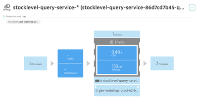

The process-level connections are ok:

In the screenshots above we can see the envoy proxies (and the services) but no tracing connection to other services where there should be some.
