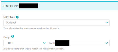

Hey everyone, how are some of you putting windows os service availability alerts into a maintenance window? Through some testing I have found that the problem card for windows services stopping is associated with a custom device and each os service seems to get it's own custom device. Creating a maint window for the host where the service runs on does not supress alerting because the maintenance window is tied to only the host AND the problem is tied to the custom device, at least that seems to be what I am coming up with in my testing.
My first test:
  - Created a maint window for a single host, using the entity filter of host and using the hostname, also configured the maint window for 'Detect problems but don't alert'

maint window used during first test
