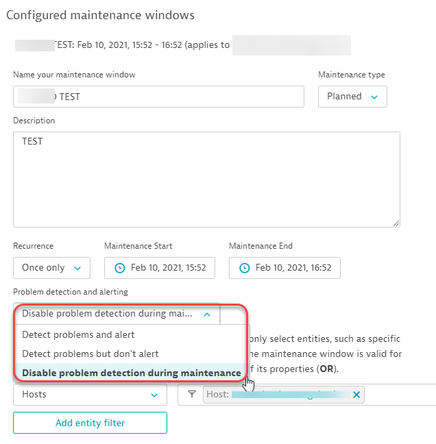

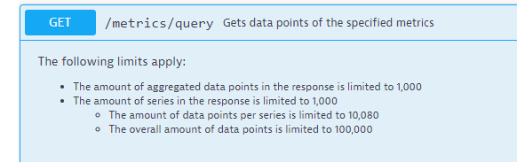

when we try to extract metrics from the api on (Enviroment V2). Metrics Query
Does not have the option or a place where to put the parameter for no considere Maintenance Windows on the Data.
just like the Timeseries. that have the option on metrics v2 doesnt have option or place to set the parameter.
On the Documentation doesnt show any relate to get metrics without maintenance windows.
Besides of adjust the query times to "working" times of the metric.
Should exist this option considerMaintenanceWindowsForAvailability as a parameter on Metrics V2 ?
23 Nov 2020 08:57 PM
It might be dependent on the maintenance window type you selected at the time. I would recommend tossing in a RFE as well to see if they can build that feature into the API.
