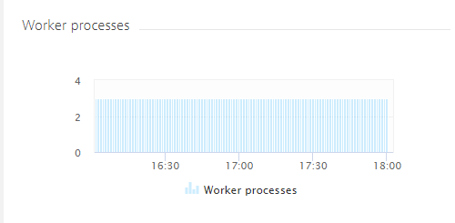

Hi guys,
Prospect asks if there is a way to monitor that there are sufficient number of NodeJS worker process (i.e. in the next screenshot is 1 of the 5 workers processes is down to get alert on that)
Thanks in advance
Yos

daniel_khan
Inactive
I don'r fully understand the use case here. The number of worker processes is usually constant and defined through the cluster module or a process manager like PM2. Usually it's the number of CPUs + 1 (for the primary) but there is no hard rule on that. So what would 'sufficient' mean in this context? The chart with worker processes you showed does not provide much value and I am thinking of removing it as it's a time series that actually always has a discrete value - this is not volatile - so the bars don't make much sense. Please let me know if the prospect can provide a use case where the number of workers fluctuates.
Hi Daniel,
Prospect says the sometimes he found that the number of worker are lees then he expected to be and lower than his threshold, may be a machine with less cpus than needed was allocated can cause that? any way the question was if there is a way to set threshold on that and get alert?
Yos
