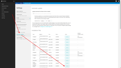

12 Jul 2022 01:49 PM
Thanks Antonio, indeed! Didn't think about that option. Back from 55 to 16 G. 🙂
