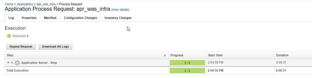

Dynatrace took 6-8 minutes to create the problem after it happened. we tested this by shutting down JVM's . But once problem is generated, problem contains exact time when the issue was happened. it will be great, if dynatrace able to generate the problem a little bit more quicker
process group was stopped at 14:05
Problem #862 in dynatrace was generated at 14:11
Email alert came at 14:12
Ticket in Netcool queue 14:12
