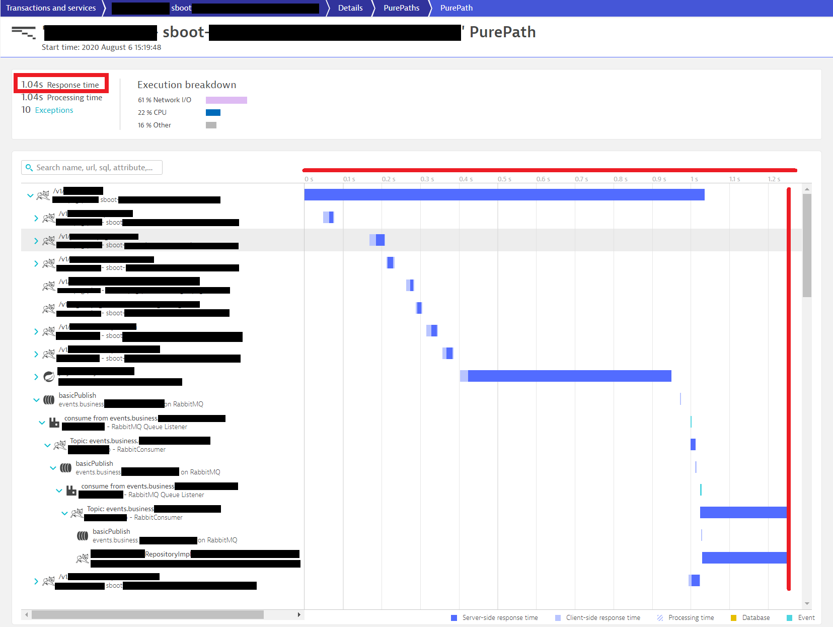

Hi all, we've noticed the purepath response time not counting the interactions with RabbitMQ into the Purepath Response Time.
I have 2 examples where we can see the difference between the whole purepath tracing time into the waterfall chart while the Response Time is lower than it.
  • That's a purepath which starts into an API, it has interactions with atomic services and them goes into 2 RabbitMQ topics which are not being counted on the response time. At first we didn't notice it because the RabbitMQ interactions happens at the end of the purepath and takes little time.
  • However, in the second case, our purepath starts on a RabbitMQ and goes processing further on APIs and MQs. As you can see from the image, the Response Time is showing as 16.2ms (which is basically the time it spends in the first MQ), while the time it took to process the whole request was almost 2 seconds.
I would like to know how could we get the whole response time/processing time since it seems to be breaking those times for every interaction we have using RabbitMQ, even though Dynatrace is showing the whole tracing corretly.
