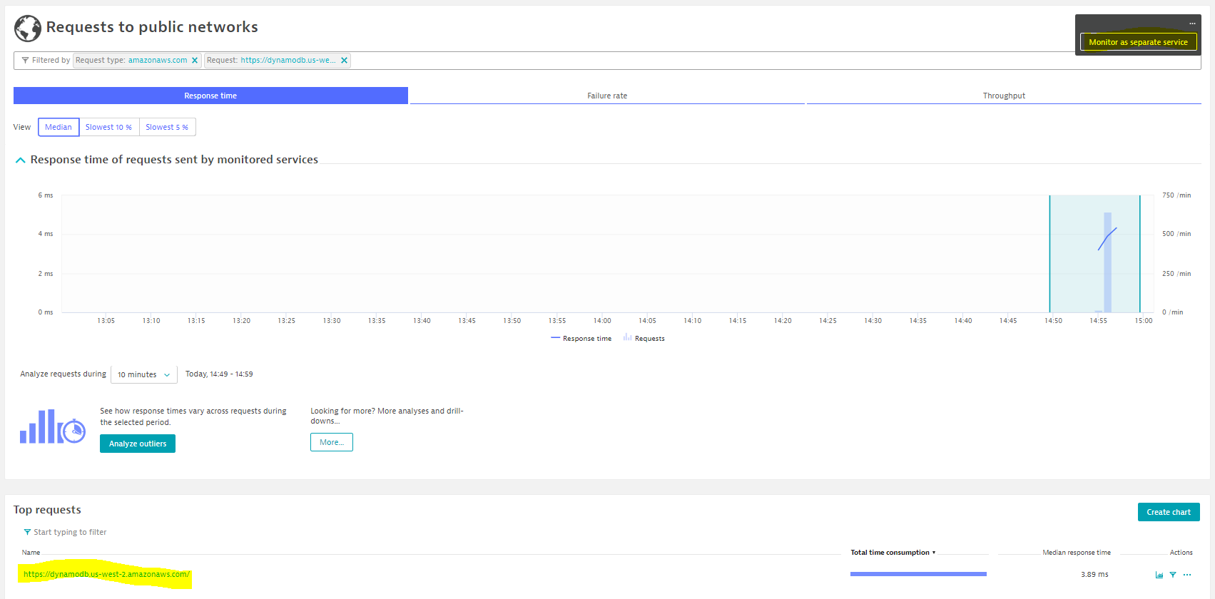

I am trying to separate out one of the Request URL from public networks.I am able to separate out based on domain,but this request URL is again falling into that domain bucket.I am not able to separate out from that domain.Can someone help in understanding how can I achieve this.

There is continuous traffic for these requests. Here I don't have option to create custom network device.
The steps I am following is
1.Go to Request Public networks & I picked one of the domain & selected one of the URL.
2.When I click on Monitor as Separate service,it was falling into domain amazon.aws.com,but I am expecting this to create as separate service based on the sub domain(dynamodb.us-west-2).
Can you please provide how can i create this as seperate service.

In this way it is not possible. Only main domain is supported. I suggest posting rfe
