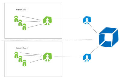

Of course, you can add a second Cluster Activegate to a Managed Cluster, even more, I recommend it.
As you can see in the schema from the link, there's a reference about "Cluster Activegates", plural.
https://docs.dynatrace.com/managed/shortlink/managed-deployment-scenarios#scenario-3-integration-wit...
Keep in mind you will need a load balancer in front of the cAGs, and then you can configure it in Dynatrace
https://docs.dynatrace.com/managed/shortlink/managed-ssl-cluster-ag#configure-dynatrace-to-manage-th...

All agents are informed about the available endpoints. You can verify this by using the oneagentctl --get-server command on any of the agents. If you wish to manage how the agents connect to a specific cluster activegate, you should utilize network zones. By enforcing connectivity from a particular environment activegate to a single cluster activegate (at the network level, not within Dynatrace), you can achieve this control. However, it’s important to note that if your cluster activegate experiences an outage, the environment activegate reporting to that cluster won’t be able to establish communication with the cluster
So I highly recommend a LoadBalancer.
