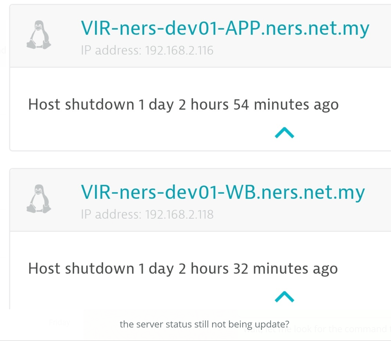

Customer has two servers reboot to enable code-level visibility after oneagent is installed, but after reboot seems like the agent didn't start itself:
So, on a sidenote, anyone encountered this before? Where after server reboot the agent didn't startup.
Hi Waikeat,
Have you tried the command "service oneagent start". I have seen this issue on one occasion but this was because the agent was installed in a custom file-system not the default. On reboot, the agent was trying to start before the file-system was mounted on reboot so the agent start failed. Have your Linux administrator verify the entry in the /etc/fstab if you are installing the agent in a custom file-system.
