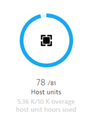

We have two application server which has 2GB RAM each, so my understanding is, it will consume 0.15 host units per host? since it calculates 16GB RAM = 1Host unit.
or it will be charged as 1host unit per host?
Below is the snapshot of my environment, could you please check if this is sufficient to enable both host?

Hi Suraj,
Up to 4 GB of RAM is 0.25 HU. HU is calculated per host. So in this case, you have two hosts with each 0.25 HU, with a total of 0.5 HU. So yes, that would be sufficient. You can always calculate the number of host units required based on the table in the documentation page below.
https://www.dynatrace.com/support/help/reference/monitoring-consumption-calculation/
