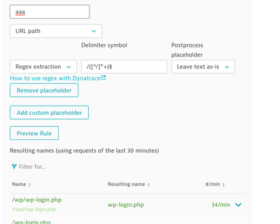

The following should work, does it?
Hi Julius,
(you missed an escape so change to ([^\/]*+)$ )
"Dynatrace says to expensive!" but after a lot of tries it seems that the solution is super simple,
(when you see it (-;)
[a-z,A-Z]+$ (or a variation of course)
KR Henk
KR Henk
No, my regex ix fine I think. You need to specify the head / as without it it's expensive. Also it depends on where within Dynatrace you are using it.
It works for the request naming rules (using the aaa placeholder):
RUM has different regex limits, so it's better to ask where you need it exactly.

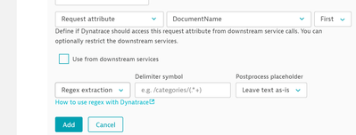

Hello Julius,
Customer was using regex in calculated metric, so you are right yours works perfect.
(except in calculated metric than mine is better (-;)
And yes I know that is very deep (-;
Thank for your reaction!
