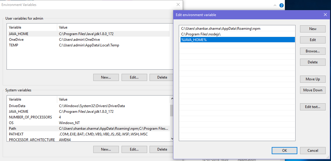

‎03 May 2019 07:47 AM
@Paul S.
%JAVA_HOME%\bin\jar
Yes it exists there, please find the attach screenshot.
Todays is our release plan looking forawrd to a earlist response.
- Mark as New
- Subscribe to RSS Feed
- Permalink
‎03 May 2019 07:54 AM
That looks fine.
Can you open a support ticket and provide your build.gradle file along with the exact error message you receive when you type the "gradlew assembleRelease -pInstrument" (or replace "assembleRelease" with whatever buildtype you want to build")
