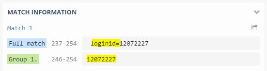

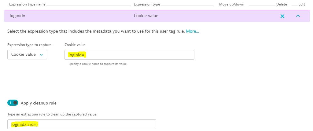

Dear All,
We are trying to get a user tag from the cookie and for that purpose we found the name (loginid=) in the cookie and wrote a regex (loginid.(.?\d+)) for the cleanup rule but even though anonymous user sessions are appearing.
Below screenshots are for the reference to configuration.

Hello Babar,
are you sure that all of those anonymous users has been signed in an have this cookie value? I have never had a problem that value was available and Dynatrace doesn’t detect it. You can always make experiment and disable cleanup rule to check if this help (just experiment)
Sebastian
Also depends if you use persistent cookies to identify recurring users or not. In this case, you can see some sessions as anonymous (on the main screen), but they have user tag assigned. Since their first session was initiated and completed before you have set the userTag extraction from cookie values.
Hello @sebastian k. and @Julius L.
Thank you for your answers. Now the user tagging is working because = sign in the cookie value was additional.

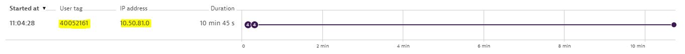

Any thoughts about the below situation?
Public and private IP addresses are capturing in the form of subset instead of an IP address e.g. 82.212.85.0 & 10.50.81.0
Regards,
Babar

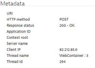

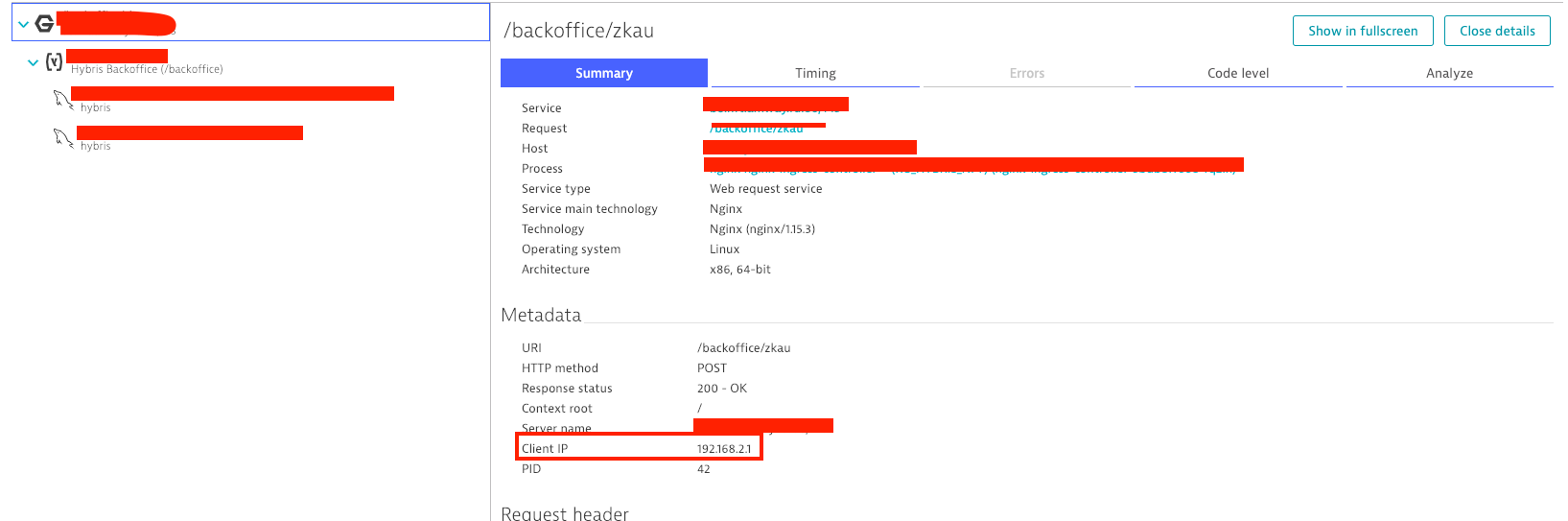

Question... if you go from user action to purepath, there you also have client IP address. Is it the same?
Sebastian
Click on one of user actions => Waterfall analysis => Purepath and check in purepath details IP cought on WebServer.
Sebastian
I mean this place
Hello @sebastian k.
Yes. The metadata also has the subnet instead of a unique IP address.
Regards,
Babar
Strange... @Babar Q. you have not easy task with this POC i think. Maybe open support ticket for this because actually I have no idea why it happens like this. But there must be some reason in configuration of environment that it is behaving like this.

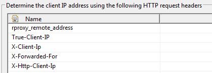

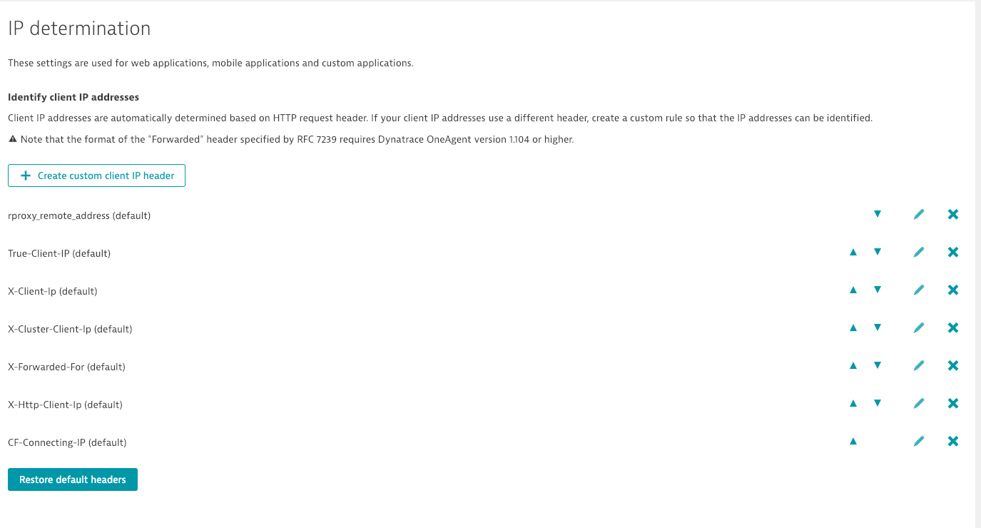

I've found something in settings:
you can setup from what place Dynatrace will collect IP. (Web & mobile monitoring settings)
Sebastian
Hello @sebastian k.
Thank you for your continues effort with me to understand the situation. Below screenshot is from the AppMon for determining the client IP address and the same headers I can see in your shared screenshot (on my side this is also the same). Unique IP addresses are available for the ApppMon but not for Dynatrace. Maybe the same header with different sequence will work for Dynatrace.

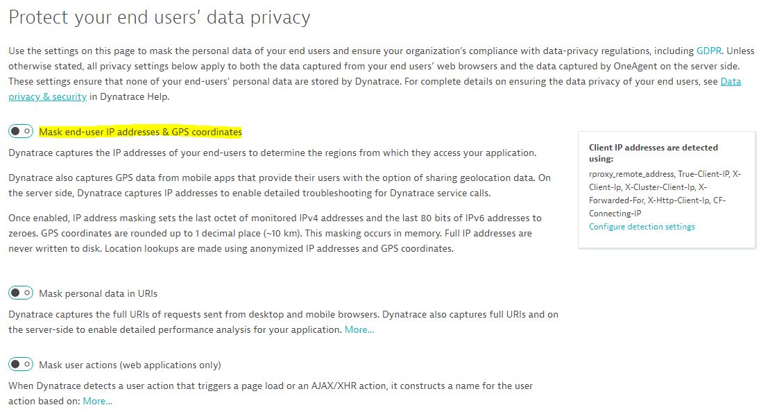

Hello @sebastian k.
I just disabled the highlighted default enabled settings and expecting to see the unique IP addresses 🙂
Regards,
Babar
Cool one issue less on the list 😄 But actually this setting is not active by default. So maybe you've switched it accidentally 🙂

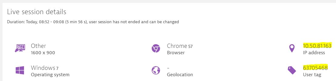

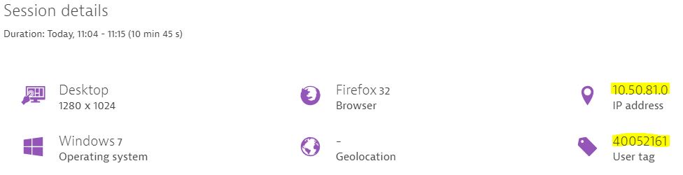

Hello @Alexander S.
Thank you for your comments. During POC we disabled the persistent cookie but encountered with a strange situation.
In the below screenshot a live session has an IP address with a user tag.
In the same session, there are multiple user tags with different IDs.
What can be the issue?
Regards,
Babar
@Babar Q. Hi.. were you able to find out way out for the above issue ? Even am facing the same issue for one of the web application. I can see multiple user tagging under one user session, also there IP addresses and browser family, versions are different, still the users are merged under one user session.

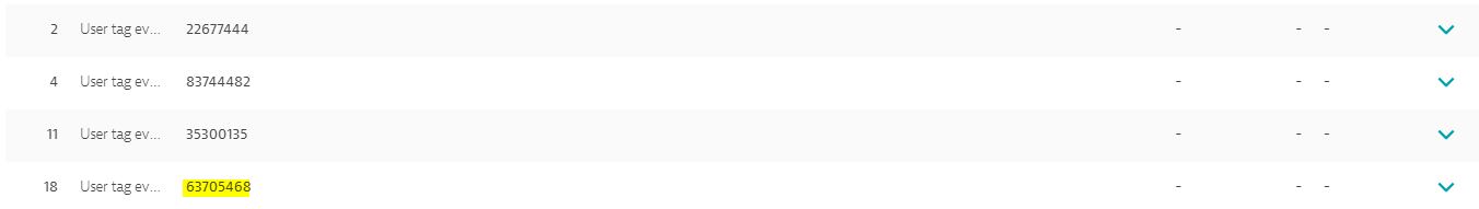

Hello @sebastian k.
Once again three points to discuss about User Tag.
What can be the reasons behind?

Sebastian
Hello @sebastian k.
No, without any filtration.
I see the tags for some other people but not mine and it always shows anonymous even after clearing the cookies (just to exhaust the option).
Yes many of them have user tags.
