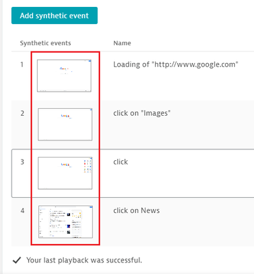

Hello Gauri,
Does previous steps successfully completed during the replay? You can verify that by looking at screenshots once the replay is completed. Check if all previous steps have relevant screenshots. This will tell where actually the script replay is failing.
It might happened that, previous steps are not completed and replay will move like fast forward. For e.g.- Page is not loaded completely but script replay trying to find a button or click which not actually available yet.
Refer the below screenshot for reference.
Once we sure that it is not able to click on checkbox then we can add JavaScript call to perform the click on checkbox.

Hi AK,
On the previous step I could see a popup in the screenshot which otherwise had not been there while recording the script. Since the synthetic did not click on the popup for it to go away, I think because of this the error is occurring.
What can be done in this case?
