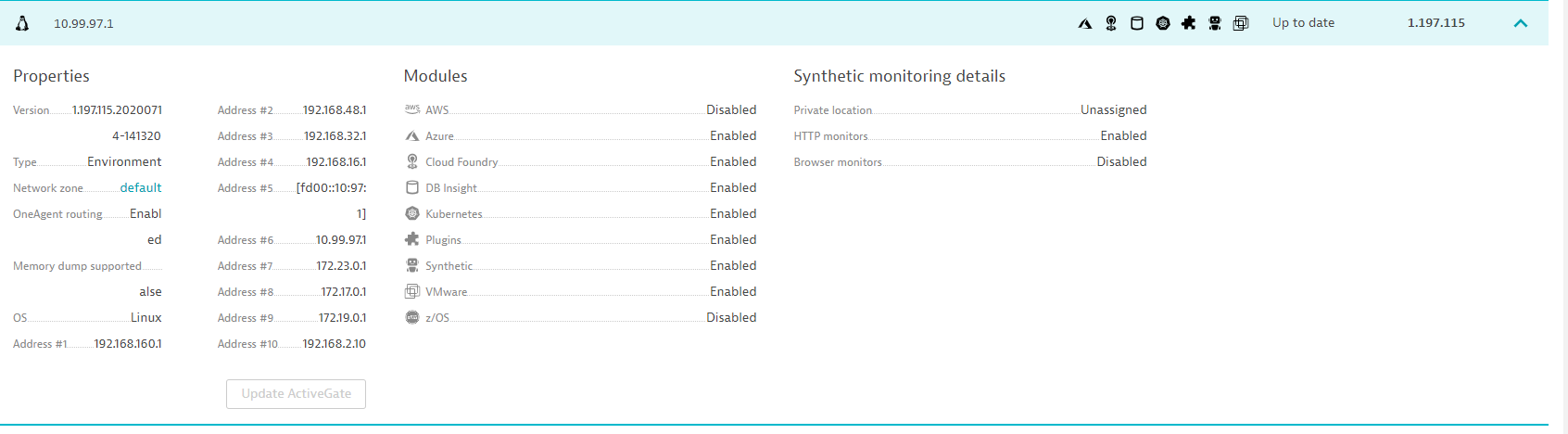

HTTP Monitors are no longer enabled by default for Active Gates that route oneagent traffic, as there are Synthetic Active Gates now.
If you just want to run a few HTTP Monitors you can still enable it though
In /var/lib/dynatrace/gateway/config/custom.properties add the following:
[synthetic]
synthetic_enabled = true
This will enable only HTTP Monitors (not Browser Monitors) for the activegate:
Dynatrace Certified Master, AppMon Certified Master - Dynatrace Partner - 360Performance.net
Worked flawlessly! Just would add that I had to do a restart of the Activegate.
Antonio Sousa
Yes forgot to mention that, restart is always needed when changing the config file.
The custom.properties will be persistent throughout upgrades.

AntonioSousa
Just a quick note that the tenant 1.211 upgrade broke the AG where I had this working... I had not updated the AG, just in case, but synthetics stopped working after AG was notified of the tenant upgrade.
