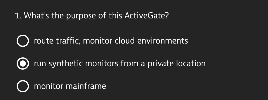

Did you pick proper ActiveGate purpose? It has to be set as synthetic AG (This will disable all other functions):
https://www.dynatrace.com/support/help/shortlink/sgw-install#select-the-activegate-purpose
During installaction you can pick purpose of AG, this will result changing install parameters:
/bin/sh Dynatrace-ActiveGate-Linux-x86-1.173.298.sh --enable-synthetic --enable-browser-monitors
Did you make it like this? If yes, you should check AG logs.
