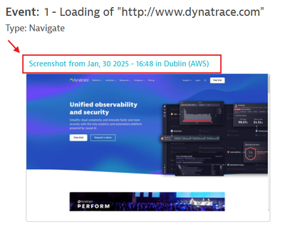

  • You can verify the origin of a screenshot by following these steps:
    1. Navigate to the Synthetic dashboard and select "Analyze executions."
    2. Select the specific execution you're interested in from the list.
    3. Above the screenshot, you'll find a label displaying the date and location, indicating, "Screenshot from <date> in <location>."
    4. Select this link, and you'll be directed to the execution where the screenshot was taken or attempted to be taken. Example:
