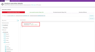

You can also, find the error code for the most recent failed, successful and on-demand executions in Analyze last failed execution. You can filter the JSON to just show the error. In the JSON the error code is called HealthStatusCode and the error description is HealthStatus.
