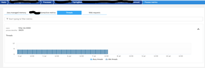

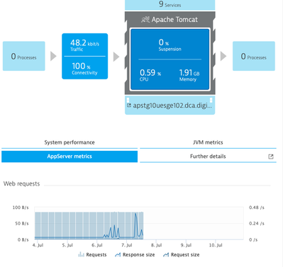

If I go to Tomcat process dashboard -> Appserver dashboard is empty
And all JMX metrics are empty
