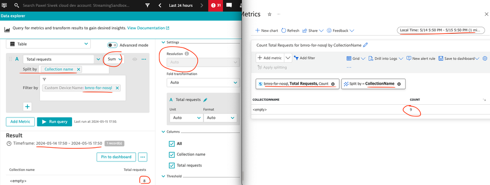

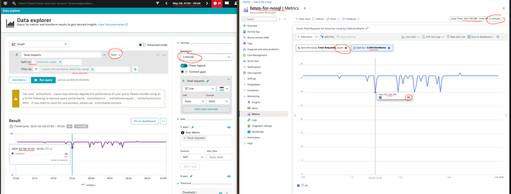

When comparing individual data points between Azure and Dynatrace within the same timeframe, with a one-minute resolution and consistent dimensions, if the data points align, it indicates that the metric capture process is functioning correctly and the data points are accurate.
However, disparities may arise when comparing aggregated data. This occurs because Dynatrace captures specific data points from Azure every minute rather than aggregating data directly from Azure itself. As a result, variations in aggregated data can occur.
It is worth mentioning that when Microsoft sends a singular value, such as a count representing a metric, it's interpreted as a "Total" on the Dynatrace platform. Therefore, the aggregation method on the Dynatrace side should be set to "Sum," even if the corresponding method on the Azure side is "Count."
For example,
Azure Cosmos DB Account (GlobalDocumentDB)
metric: ext:cloud.azure.microsoft_documentdb.databaseaccounts.totalrequests
For individual data points:
For aggregated data:
