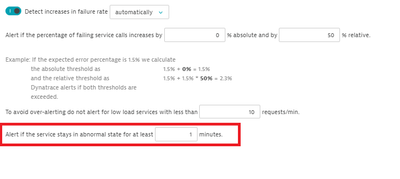

Hello, I am a Korean engineer.
I don't want to create a problem about the case that has been resolved for less than a 1 minute.
Even if I set it as above, the problem within 1 minute is expressed.
How should I set it up?
Thank you in advance for your reply.

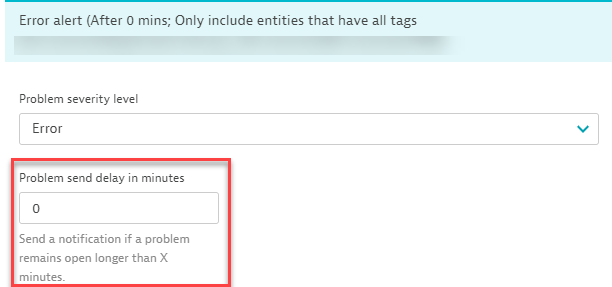

you can edit it there, where you have shown the error detection, or you can set it at the alert profile by stating how long you want a problem to be open for before it pages out an alert 🙂
Keep in mind tho, that this will apply to everything that falls under the Error Alert Rule and the scope of your alert profile.
