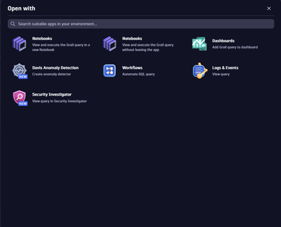

| limit 20Then again when you click open with you find something like this.
click on Davis anomaly detector and you will be redirected to the Anomaly detector Application where you can create the event.

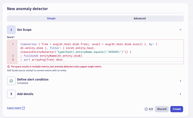

25 Jun 2025 08:56 PM
I tried following your solution as I am interested in a similar setup, however when I get to setting up the anomaly detector, I get the following error with my query: "The query results in multiple metrics, but anomaly detectors only support single metric."
*I replaced the server name to "XXXXXX" in my screenshot, but when I put in an actual server name I get the error*
Does this functionality no longer work, or am I missing something?
Thanks.
