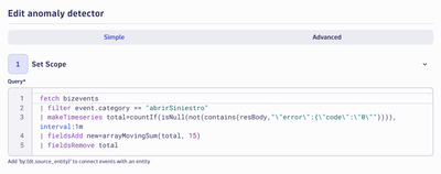

I need to put a problem we generated in the Davis Anomaly Detector into a management zone. The problem is that the alert comes from a business event and does not recognise any entity as a problem. The environment appears, and then we cannot relate the entity to any MZ.

Could you show us how is the alerting condition for this business event?

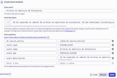

In your event template, the dt.source_entity is set to {dims:dt.source_entity}. This works only if the metric or DQL query includes a valid entity dimension.
To ensure the problem appears in a Management Zone:Use a dimension like {dims:dt.entity.process_group_instance} or {dims:dt.entity.service} depending on your metric scope. Check that the entity referenced in dt.source_entity is tagged or scoped into the MZ you want, you can use autotagging rules to ensure consistent MZ inclusion.

Hi @Pablo2 ,
What you can do in this case is create a Custom Device (Name it as <Application Z- Your Application Name Here> or tag with your application name) and when an error occurs in your bizevent case, tie this to the Custom Device that's created using dt.source_entity property.
In the snippet you shared it's the first property. In the value you can remove {dims:dt.source_entity} and give the Custom Device ID that you created.
Then in the management Zones, add a rule that Custom Device with Tag <Application Z> belongs to this management zone.
