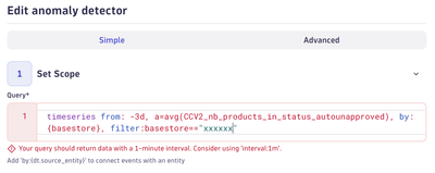

I. have a "slow" metric/timeseries, where a metric data point is produced only every hour. In a normal Notebook/query I can easily apply the Anomaly Detection (Auto) with whatever window or datapoints I want, and it works fine.
However the Anomaly Detectors expect a metric resolution of 1 minute:
IMO for the anomlay detection it doesn't matter if the datapoints are far apart or not, it is just the amount of datapoints that is relevant, right? So for a "slow" metric I'd like to analyze a longer timeframe of 72h (=72 datapoints) and not just e.g 1h with - in a one minute requirement - 60 datapoints.

Yes, that’s correct — this is indeed a limitation of the Davis Anomaly Detector.
Just like with the old metric events, the detector currently expects a 1-minute metric resolution and only analyzes data within the defined window size (up to 1 hour maximum).
So, for “slow” metrics with hourly data points, the Davis Anomaly Detector won’t perform well, as it doesn’t adapt its analysis window to the lower data frequency.
