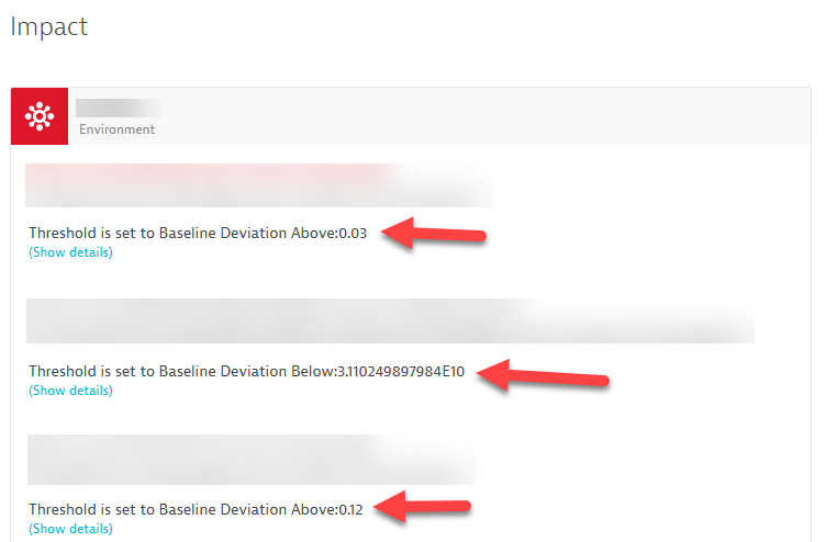

Within the Events V2 and the Davis Anomaly Detectors you have the ability to provide Dynamic placeholders. However, If you are leveraging Seasonal Baselines, It appears that you cannot use {baseline}. Is anyone aware of the placeholder for Seasonal Baselines? We leverage these to provide teams clear indications as to why an alert was triggered.
Test 1 : Seasonal Set with the two Dynamic placeholders of {threshold} | {baseline}: Results: FAILED
Test 2 - Auto Baseline Set with the two Dynamic placeholders of {threshold} | {baseline}: Results: WORKED

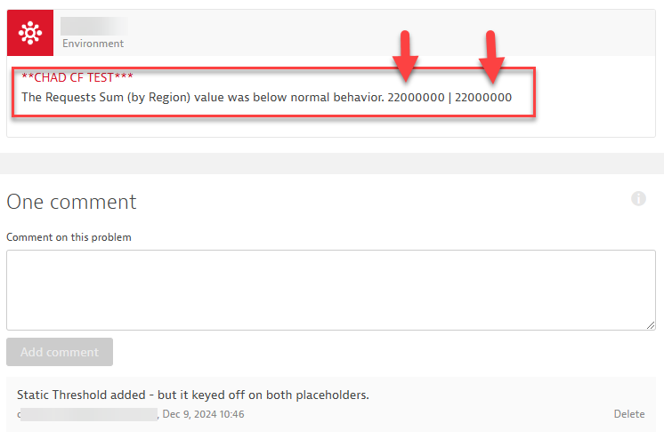

Test 3 - Static Threshold with the two Dynamic placeholders of {threshold} | {baseline}: Results: WORKED but listed in both segments.
