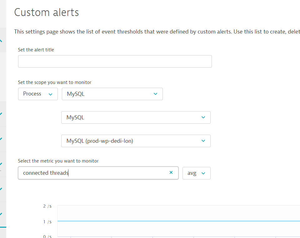

If you go to settings -> anomaly detection -> custom alerts you should be able to do it there.
You can then set up a custom alert for either a specific MySQL process or the whole process group for MySQL. I have attached an example.
