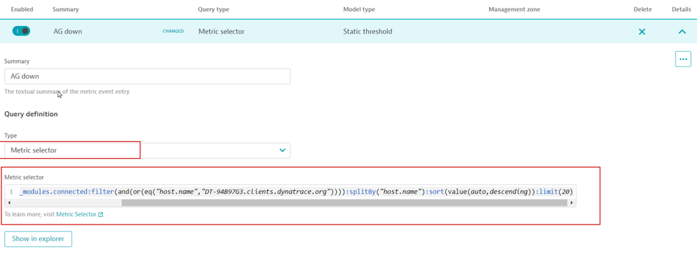

What is the way to get alert if ActiveGate goes down?

@Ldisztl92 Thanks for your message, i dont think this will work as out. I found better option for this i.e. ActiveGate metric "Active Gate - Communication - Agent Modules - Connected"
