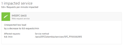

We have "Unexpected low load" alerts and we think alerting is not working as expected because some alerts are raised when de load of a request is not reaching the thresholds set. E.g:
  • Settings:
Does this configuration means that an alert will be triggered when traffic decreases 90% (or more) than expected during 15 minutes? This means, an alert will be triggered if there is  only 10% (or lower) than expected?
  • Example: an alert was raised when the is traffic is not zero and with no significant changes:

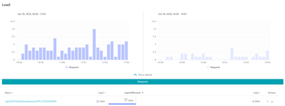

If we do a comparison:
   - 2 hours before:

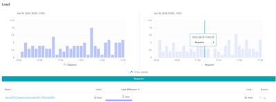

   - 1 day before

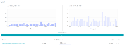

    - 1 week before:
The key here is that 3 weeks ago I changed the settings from 80% to 90% and now I'm getting more alerts than before.
Is this behavior correct?
