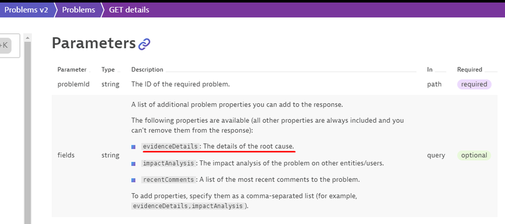

You can use the Problems API v2 - GET problems details and use the evidenceDetails property for the entities identified as the root cause.
BR,
Cesar S.
-César S. -
Thank you for this, this is good. Is it possible to use this in the problem notification webhook?
Yes!
You can use the ProblemDetailsJSONv2 as a placeholder in the problem notification webhook, then you can use these properties/objects like evidenceDetailes, impactAnalysis, and recentComments.
